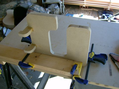

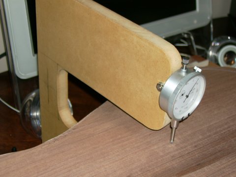

I made my molds and some other stuff from MDF. Check the link in my sig and you can see my molds. Here's a thickness gauge I made.

Charlie, I should actually be finishing up my molds today. I bought a half
sheet to make the body mold and bending mold. I made a bending mold
out of MDF in 2002, and it's been outside everyday under our covered
padio. Rain, cold, 113 degree heat - everything - and it's still sound and
true.
